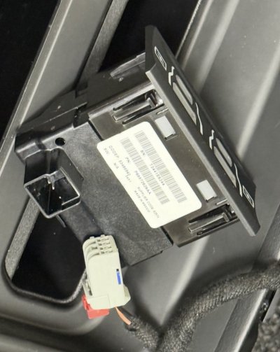

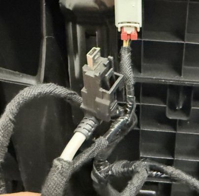

The rear USB module that came with my console is p/n P68572629AA. It only has a 4-pin connector on the rear, no USB Micro Female connectors. It has the “charge only” (battery with lightning bolts) printed on the front, not the USB multimedia icon. There was a loose USB Micro -Male connector in the back of my console, not connected to anything.
I have found a couple of part numbers for other rear media hubs that have the USB trident logo on them, and they seem to have the 4-pin plug, plus dual USB Micro-Female connectors on the back.
P68330429AF
P68402777AF
Do we think that swapping one of these modules with the USB-Micro-female ports would do the trick? Maybe need to plug in the loose USB Micro-Male cable at the back of my Console?

Future Searchers, this is Resolved: replaced rear usb hub that was charge only with one that is a “media” usb hub, which has USB-micro-F connx on the back. I plugged the 4pin connector plus the loose USB cable in. It doesn’t seem to work as a media hub with the Uconnect, but it does charge things now, and that is what I care about.
