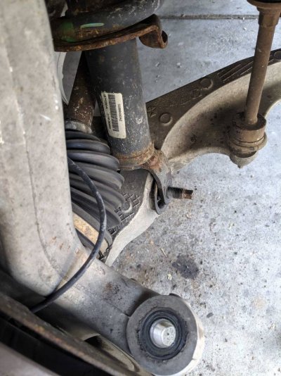

Went to level the truck today and ran into a slight issue. Lower strut bolt is stuck in the bushing. I kinda figured it would be. Called around and can't find the lower bushing and bolt. Dealer only sells the entire control arm (no way I'm doing that) and my air compressor just shat the bed. So no air hammer. Can't use heat without destroying the rubber bushings so I'm kinda in a pickle. Any suggestions? I can slap it all back together as it sits right now. I haven't started hacking anything apart yet as it's my daily and I can't be without it for more than a few hours....... I can't beat on the bolt much more without deforming the head and the bushing is spinning with the bolt. I'm stumped at the moment.

So I got most everything apart on the driver's side today. As expected, lower bolt seized. Sold my spare truck off last weekend so I had to bust out the old mountain bike to make a run to the hardware for some cutoff wheels. Hacked the bolt free on both sides and the strut top nut refused to break loose. Since these struts have like 4 bushings and shields, u had no way to grip the shaft to try and get the nut loose. My final attempt resulted in me snapping the hex portion of the strut rod off. It was still past the nut so it's safe but enough for me to admit defeat before ruining the strut completely and having no options.

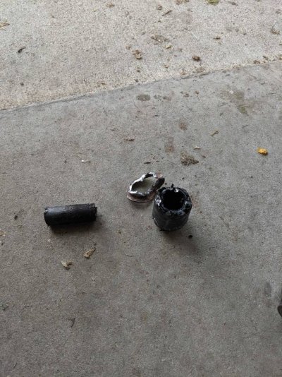

This left me with the bushing in the lower arm still left to tackle. I finally got so sick of fawking with it I took a map gas torch and burned the inner rubber out enough to drive the center sleeve free and that allowed me to royally c*ntfuckulate the outer part of the bushing enough to drive it out. New one went in nice and smooth but that lower arm got a few battle scars from my relentless air hammering. Nothing substantial but it's not pretty.
