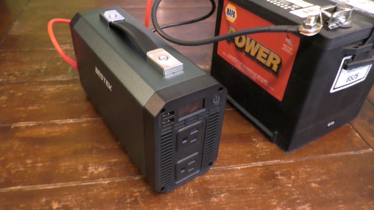

Depends on whether the fridge will run for a week-end when you're camping.A dual battery set-up which Tron mentioned is probably a wise way to do it,as it'll also let you run a few other 120 volt accessories.
This guy uses a continous duty solenoid as his isolater,which is basically all a battery isolater is.
But there's lots of video's using an off the shelf isolater
