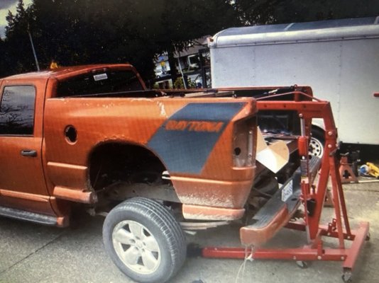

Btw here is how farm boys get at the fuel pump when the shop is full and tank is full
Works fine he said , everything is chained to truck so the engine lift can’t move.
