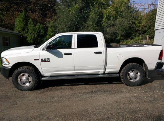

305/70/18 Cooper Discoverer STT Pro with 2 inch level. Did the level when I got the tires. Looks perfect leveled with those tires.

Well my pictures are in this thread of the 315's being on my truck. It comes really close to rubbing on the sway bar but that is it.
