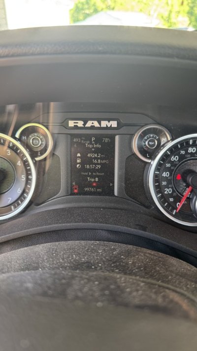

Here’s what the computer says I did over the last almost 5k miles (my oil change interval).
The mileage reading from the truck is most likely off by a couple miles .
And it always claims you get further, for some reason only Mopar executives have the answer.
Calculated by person will give a more accurate picture.
Very true, but it gives a rough idea.
True, though my 2500 is most times high and but also occasionally lower than hand calculated. It is always in the ballpark, rarely out more than 1 mpg and I track 100% of my fills and record actual vs EVIC calcualted.
The issue is, the OP's EVIC mileage is 10 or less, so likely around 9 on average. I have never had mileage like that unless I did a ton of idling or was in low range for the whole tank. Highway at 55, his EVIC should be 16+. Tells me he has an issue.

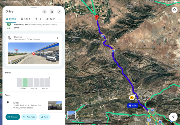

Try a route like this. Fill up in Sylmar. Get on the I-5. Set your cruise for 80mph, a little slow for this particular route but it’ll get you there. Turn around at wheeler ridge and come back. Refill at the same station in Sylmar. Divide the 120mile trip by gallons used. You now know what you’re going to get for real world mileage and how much your speedometer and odometer are off.
