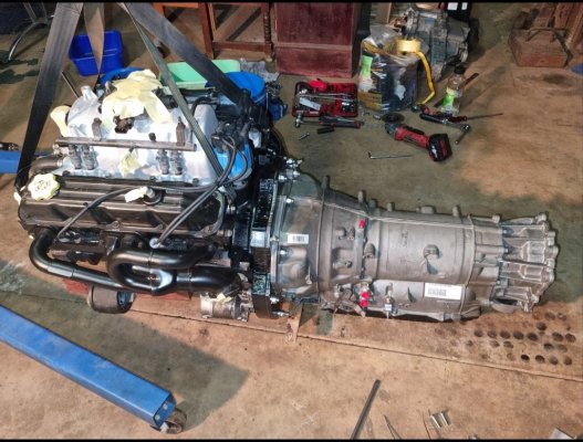

I've recently installed a 2014 8hp70 from a 2014 Jeep Grand Cherokee 3.0 eco diesel into a 1996 2500 2wd 5.9 magnum with 3.55 gears.

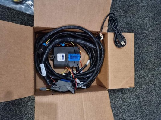

Even kept the stock crank position sensor . I bought a Sound German Automotive TCM for $1000 USD.. just need to find somwonenwho can tune it now..

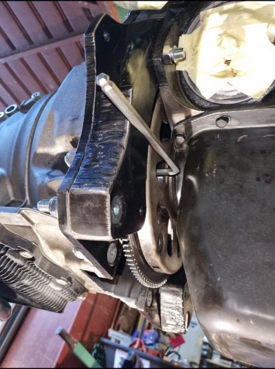

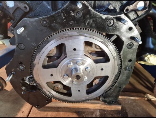

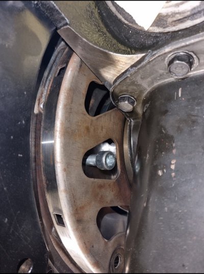

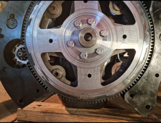

It does start because it has the flex plate sandwiched in the factory position. The adapter plate only works as an adapter to the torque converter adapter but also holds the ring gear in the factory position.
In these better pics it shows the factory external balanced flex plate sorry mate

Haha cheers mate. Yeah went for the Sound German standalone TCM. It allowed me to pull the stock tune from the transmission through HP Tuners.. but looks like it is only a gateway to provide inputs to the transmission like RPM etc for torque tables.
In hindsight, something like HTG self learning would be "easier", but I don't like self learning or want to modify the internal transmission chipset with the wires / soldering job they all recommended.
It was pretty simple to wire it in. Just tapped into 5 wires that went to the TCM and it's good to go (finalising the correct tune though)
