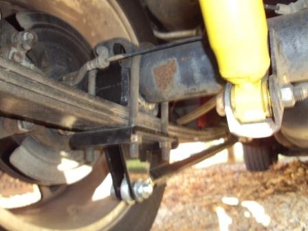

Here's what mine looks like in the rear now, this is what you're shootin for:
BEFORE:
AFTER:
