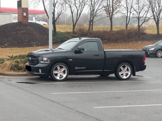

Do the ihc 3/5 or 4/6 kit order the 3/5 you can make it 4/6 by leaving one Part out it you want.
If you're thinking supercharged, I'd suggest you go truck 6.4, you'll be money ahead with less hassle.
I have a supercharged RCSB. Go 6.4 and don't look back

Thanks. What I don't know is if I bag it, do I need the new drop or just keep what I have. I already have a 4/6 drop and would end up going with the 3/5 if needed. Prefer to drive with a 3/5 drop, but would love to drop lower when parked. As for the HP gain, I have been watching Moe's builds with the 6.4. It's under consideration.
I wouldn't bag it, in my humble opinion. The 3/5 ihc kit is proven and rides nicely. If you go 4/6 it's also proven and rides nicely.
I've put over 45k miles on.my ihc kit and my largest problem was blowing out the control arm bushings in core 4x4 rear control arms.
I you want to bag it, it will be a lot of effort and it's irreversible. I can put my truck back to stock in a weekend
If your going to keep it as long as you say, cutting up the truck for bags is well, a big deal

Thanks for the bagging info. I already have a 2/4 Belltech drop on it, no complaints. I just want it a little lower and 3/5 or 4/6 seems the range I'm looking for. As for bagging, I wouldn't be driving around with it low, keep it in the 3/5 range. I would like to just be able to drop it to the ground when parked, that's about it. I'm not too concerned about long term. If for any reason way down the line I want to sell it, it is what it is. Otherwise, one of my kids inherits it.

Thanks @Bigskyroadglide. Nice ride. Is that a 3/5 drop on 20's?

Thanks for the comments.
That's an IHC 4/6 on 22s.
Bilstein 4600s front Bilstein 5125s rear, with rear shock extensions to keep the 5125s straight up and down
Core 4x4 upper lower rear control arms, panhard bar, with a road master 2500 rear sway bar.
It corners like it's on rails.
Here's a partial shot of the truck with 20s.
