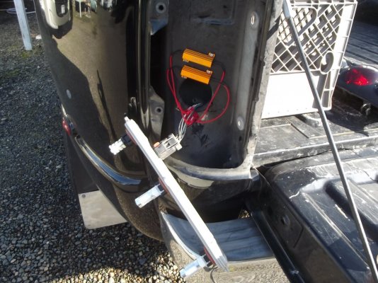

Yep-for the brake lights. You need a 6w 50ohm resistor for each turn signal and one for each brake light. I'm not kidding. When I did my leds throughout the truck the brakes looked like an ambulance on steroids. With no resistance the controller reads it as a light out and does weird crap to the circuit. You want to be sure and mount the resistors on metal because when you sit with your foot on the brake pedal at an intersection those bad boys will get really hot. I'm going to try and attach a pic of my rear housing with them installed.\ The only lights that didn't require the resistors were the backup lights, running lights, and cab lights. You want to connect them to the positive side of the harness and then to the ground. Good luck

We will definitely try that, that’s for sure. Where did you get your resistors? I went online to Oreiley's and they have these which are 12V 6 ohm but don't say anything about their wattage. Would these work? I bought a pair of these 4 and a half years ago to correct the hyper-flash of a pair of LED 3157's I put in my headlights on my old 2008 Ram. The Anzo LED tail lights I bought had an included resistor pack lookin' thing that was with each tail light but I figured it was just for the turn signals. Hell for all I know, it coulda been for the brake lights, too.

Those will do the trick. I bought some off ebay for cheap and that is exactly what they were. I paid a few bucks more through NAPA and what a difference even though they were all rated the same. You shouldn't have to cut any wires if they come with the clip connectors. Also, if he decides to upgrade his fog lights he won't need resistors for those. And if your cousin hasn't upgraded his backup lites to led he will definitely want to. I can't believe how much brighter they are over the stock bulbs. When I put my rig in reverse it's like turning on flood lamps haha. Hope that helps.
I think I got the numbers reversed earlier-should be 50watt 6ohm 12V. The watt isn't really relevant, just the ohms and volts.
