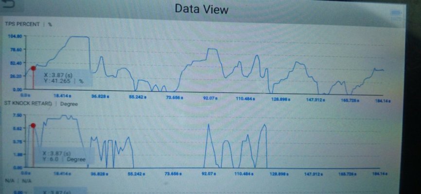

Hello yall. I got a real problem child ive never seen before. I drive the same way to work every day. I can 100% feel the power loss. Its the difference in climbing a hill at 50mph at 25% throttle, then next time it takes 80% throttle to get up same hill barely getting to 50mph. Watching data, appears that something is ringing the knock sensors, causing ecu to pull up to 7.5° timing......which kills power and fuel milage. Had a lifter chatter at startup, replaced all lifters no change.....removed, checked exhaust manifolds for warpage, reinstalled with new gaskets and torqued to 25ft lbs.....no change in knock signals or running... ive NEVER seen anything like this. Fuel pressure is verified under load, fuel trims all appear normal.....all new denso 02 sensors. New coils. Plugs. Intake manifold is sealed. New iac. New tps. New intake air temp sensor. New map sensor. New cam sensor. New egr valve. New purge valve. New pcv valve. Catalytic converters are both clear and functioning. Can anyone help?? I would greatly appreciate it. 2005 ram 4.7

I have not done timing. Haven't seen a need to it runs perfect except when it does this. 130,000. I'd like to add, I have noticed and verified it last night, the truck seems to run perfect if I unhook the battery, clear pcm. It'll run for about 15 mins amazing, then slowly start to get worse. Tell me its a sensor.

My way of thinking is that the knock sensors are clearly showing activity, I'm not sure what's causing it but I'm guessing that's the Smoking Gun considering it's pulling seven degrees of timing when it happens

So I did just verify twice that the truck runs perfect after you've unplugged the battery for about 10 minutes. Then about 10 minutes after driving it it starts running like s*** again, which tells me it's getting bad data from somewhere but I don't know where everything seems to appear normal..... can anyone verify whether or not the PCM pulls timing after a reset? Like is there a specific drive cycle it has to do before it starts pulling timing? I would think it would do it immediately to prevent catastrophic damage
