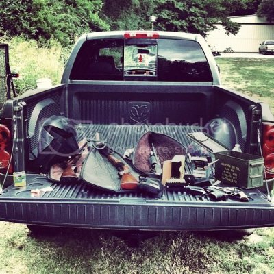

Here are some photos.

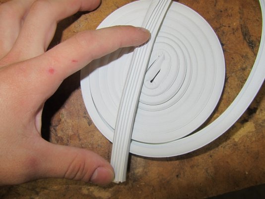

Don't buy a new 3rd break light, and DO NOT use silicone. I used silicone and that was not only messy, but you can't remove the light without nearly breaking the light. Big mistake. There is this gasket material at lowes/home depot that you need to buy. Ill go snap you a photo here in a few of it.
EDIT: Here ya go, they should have it both in white and black, id get the black for your truck, you don't see the gasket at all when applied though if you do it correctly. It has an adhesive backing on it;

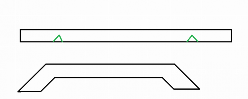

Now when you get the gasket you want to cut two little triangles out so you can fold it along the curve of the upper section and the sides, and then put a straight strip across the bottom connecting the curved section. I drew up a little diagram for an example.

-Is that closed cell foam, or a rubber material?
It is a rubber gasket material. it has a 3 hole hollow membrane that runs through out it, this allows the gasket material to be squished nicely. Even if water made it into this hollow membrane, it will not go into the truck as its a solid design, just has a hollow core.
