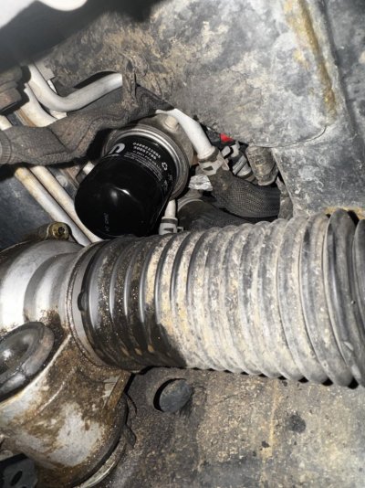

Updated pictures from the front tie rod area

I would have to call the shop and ask. But I just got under the truck and it’s leaking near the front right tie rod
Could that leak be from the oil filter?
Not suggesting that is causing your steering problems, just possibly where you’re seeing the leak.
I think that's just spilled oil fron the last oil filter change, unless it was cleaned off after oil change and its new oil leak from a loose filter that is right over that mess.
