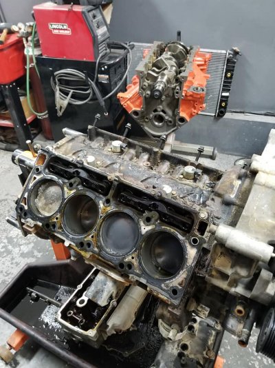

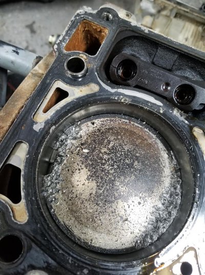

well i didn't waste anything because I haven't bought anything yet. Needs new pistons and heads for sure as they are ruined. So i'm debating on just rebuilding this entire engine and having it re-honed assuming the #8 cylinder isn't damaged.
Pistons, rings, heads, bearings, oil pump all are a must, along with the other usual parts. I know everything can rebuilt to an extent but you have to factor if the cost is worth the reward. I was just simply trying to research if I can pick up this 2014 VVT engine and make it work for cheaper than rebuilding an entire engine.

That looks like a 6.1 over by the welder...use that, it will compatible :)
HemiLonestar
Navy Badge Coast Guard
Jun 1, 2012
6,791
4,664
MD
It is :) i'm building 2 of them now. one for my 70 challenger, and the other one doesn't have a home yet.
There ya go then lol. Just a matter if you want to keep your MDS or tune it out completely. If you want total plug and play, use your stock heads (or better yet, fresh set of big valve) on the that block. Pick a cam, dress up the exterior with your original truck engine parts and drop her in and tune it.
