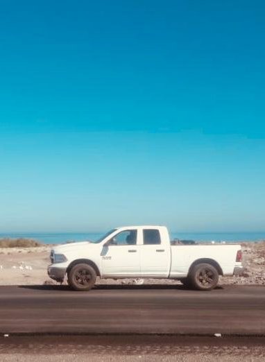

Hi,
i know ive put this up before i just suck at finding my own threads. I have a 2014 Ram 1500 2WD and i wanted to level the front, replace my shocks and springs on both front and rear along with the Uppers. Im looking at Bilstein as an adjustable alternative, however I've seen some 2.5” leveler blocks out there also. Which is a better option? The trucks got 118k on it and the front needs replaced. Are there alternative shocks to Bilsteins? What have some of yall done? Oh yeah the truck aslo has rims with the wrong set back, spacers? Any help?
I have the exact same configuration and was looking for either a leveling kit or adjustable shocks. I wanted to get the Bilstein 5100 front shocks but those don't fit my truck. TBH, the options are quite limited for 2WD Rams, hence I ended up getting the Daystar 1.5" front leveling kit for about $50 shipped.
So far so good, but I wish I had gone with a 2" or 2.5" kit since the front is still not quite at level with the rear.
When I took my truck to get these installed the shop manager told me they wouldn't recommend anything above 2" spacer up front, but I can't confirm such claim95d4bfaf4cb1d6465afc13ed79285b75.jpg
