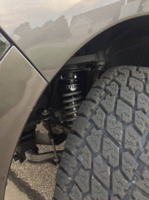

I wouldn’t put the Zone or any other brand arms that correct for angles on a standard 4” lift, it can put the UCA angle upwards in a bad position. If you add Bils to the lift then ok but not with struts at stock height.
Here’s a pic of what I’m talking about.
Excellent advice!
Do you know if that truck has the Fox 2.0's set at stock height? They go up to 2" lift. I'm just wondering if they upped the height on the Fox's if that'd solve that UCA angle.
