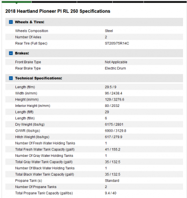

Here are the specs for the camper:
As far as the gearing on my Ram I'm not sure how to tell. All I really know is what the specs are on the dealer website when I bought the truck and the various websites for Ram that I've visited.

As someone else pointed out, find a CAT scale and weigh the truck and trailer loaded up the way head out. Ideally weight the truck without the trailer, then with the trailer but you want each axle individually (front, rear and trailer). These numbers can help you determine if the WDH is set up properly also.

What @crash68 said find a CAT scale, get your weights for truck and then truck trailer and calculate your tongue weight between 10%-15% adjusting where things need to be. Then, set the Tow/Haul button and let the truck do the work.
