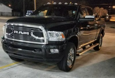

6AB6FB70-14DE-405B-A72A-423AB66D7B64.jpeg The salesman told me I had a 2” lift on front and 1” on rear of my 2017 2500 Limited 4x4 SB looks very level to me.
