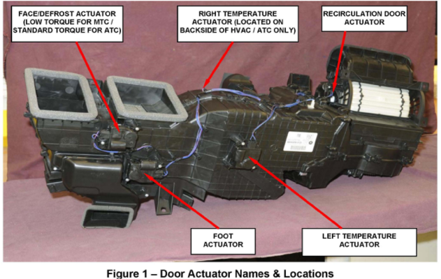

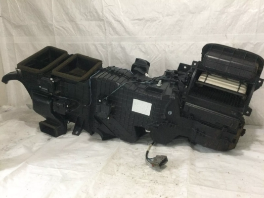

I miss stated actuator positions above ...
I wrote Mode Door, it should be Blend Door is the actuator & door is found by removing the lower glove box door, then look just to the left of the blower
Blend Door is the door that directs the air flow either for heat or to cold air
This top image , i believe is for MEGA CABS & Vans
Most of our Rams only have 1 temperature Actuator, located where it reads Left Temperature Actuator
Ram HVAC Units are basically the same in the years 2009 - 2018 & possibly newer
It is likely that there are 50 or more YouTube videos on trouble shooting Ram HVAC Systems
I will not include the Gen 5 Ram , ( new Body Style )
