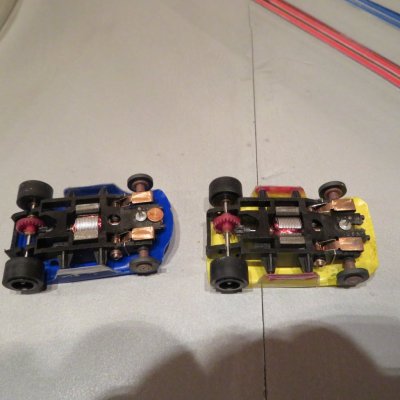

You're right a DPDT double pole/double throw switch is usually just 2 SPST switches using a common switch.
I used to build HO slotcar tracks on the side years ago,and using DPDT switches was a requirement if you wanted to wire in dynamic brakes and also use a switch to reverse car direction,same with remote nitrous bottle openers,lol.
