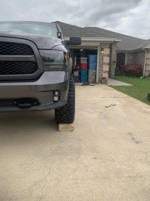

Is this setup too much offset?? I want the tires to stick out of the OEM fenders around an 1"-1.5". I'm finding a lot of different answers. Also trying to see if maybe even 35x12.5 will fit with same wheel, seen it's a possibility as well. I have a 2" front level on 2019 1500 Classic

I’m running 35/12.5/17 Kenda Klever R/Ts on a 17x9 -6 offset Pro Comp 32’s. Tires stick out from the fenders about what you’re looking for 1-2”.

I trimmed the fender liners when I was running 275/65/20 (34x11.4)on the OEM 20x9 +19 rims prior to doing the Bilstein 5100s, but otherwise no.
I’ll get some pics on the morning and hopefully that will help.
