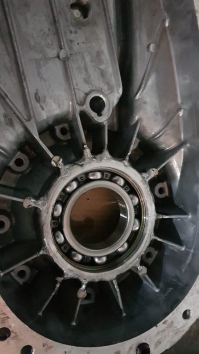

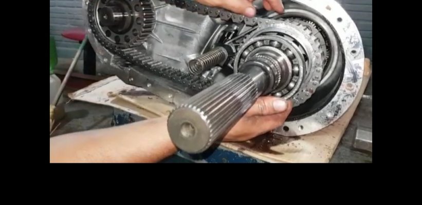

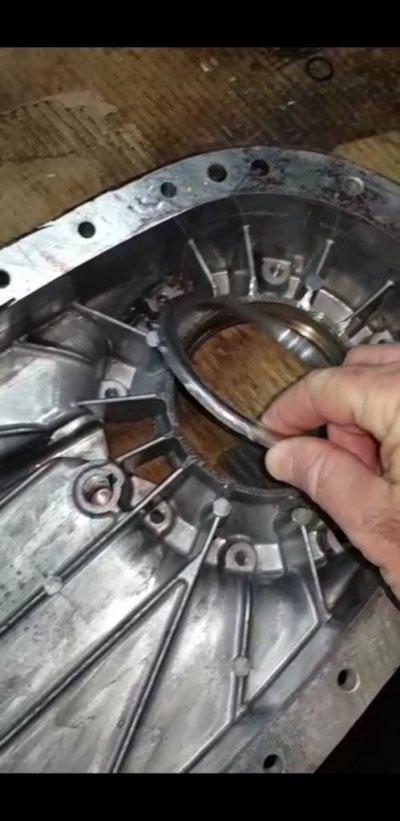

Hi guys. Finally found the issue with my truck, it was the transfer case as thought. A part of TC rear facing cover, where the rear bearing of the main shaft goes was broke due the accident that hit hard my rear end. Lot of metal shavings was found and chain was pretty loose. Bc of lack of parts needed to repair the TC, i decided to remove the chain and the broken part soldered in position to hold the bearing in place until i get a new TC from US (will take several months). So far truck rides very well and very happy i can finally use it. Thank you guys for your help! And if you have any recommendation but getting a new TC will be welcome! IMG-20220323-WA0016.jpgScreenshot_20220325-184027_WhatsApp.jpgScreenshot_20220325-184123_WhatsApp.jpg
