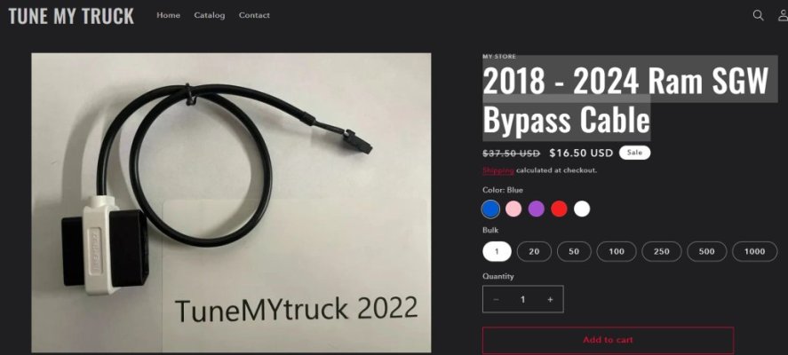

Thanks Again...I found this 2018 - 2024 Ram SGW Bypass Cable, looks very simple or basic...Hope it would work...
