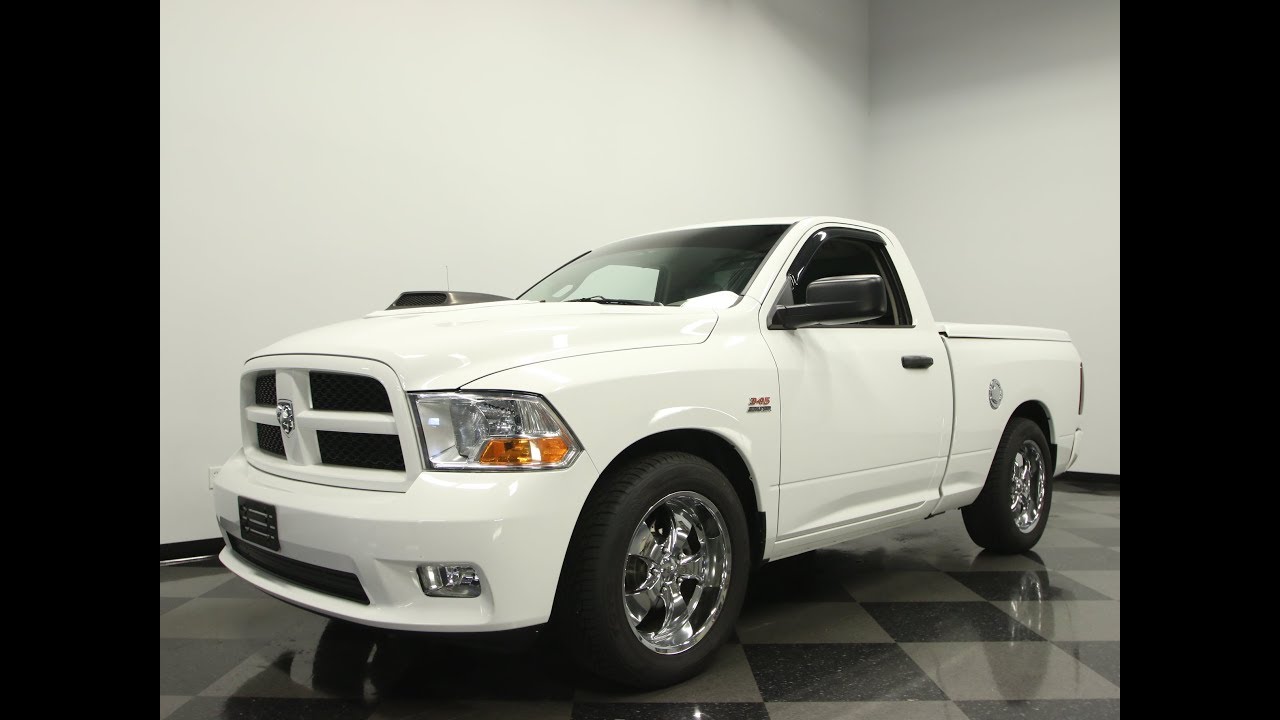

Used to be a boat outfit in Florida that was making a functional shaker hood scoop for the 4th Gens,that looked really good on the trucks,but i think they went out of business a few years ago.
I've always loved the rims on this truck

Chrsyler did a bunch of wind tunnel testing with scoops in the 60's,and that's when they discovered that a scoop had to be 2" or higher to get above the dead air space /boundary layer to get any amount of ram air from a forward facing scoop,that's basically when they came out with the taller scoops for their drag race customers.
About the same time GM discovered that the high pressure area at the base of the windshield was also a good place to have a rearward facing scoop,and that's when they came out with the rear facing cowl induction hoods seen on the early Z-28's and 70/71 big block Chevelles
