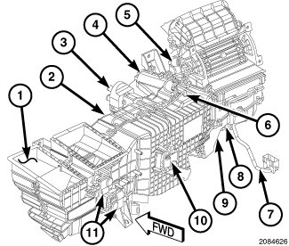

2010's are all electronically controlled, no vacuum or cables involved. For the blower, the most common issue is the resistor. It's right by the blower motor, #9 in the diagram.
As far as the defrost, it could be one of the mode door actuators. (#11 in the diagram below) This thread has some more info
