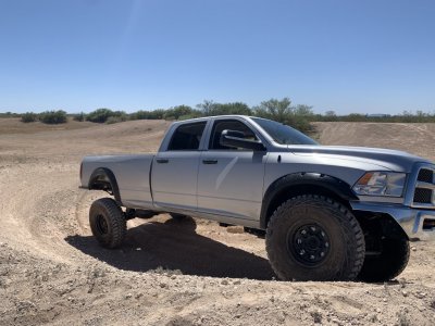

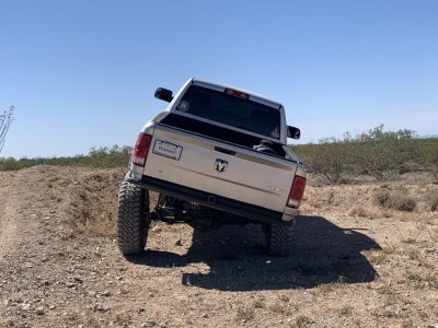

22hemi13
Mar 20, 2013
3,806
5,804
Tucson AZ
2014 2500 4x4
Yeppers. They’ve nailed it. AEV is stockish. If you’re towing Thuren will squat unless you ad air bags. Question is what is “off-roading”? If you’re looking for better off-road manners then hands down Thuren or Carli. Mild off-roading and more towing go AEV. And yeah AEV won’t flex like Thuren for sure
