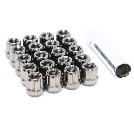

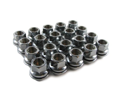

you need an open ended lug nut since it has the plastic center hubcap, just make sure the outer dia fits the wheel hole dia before you purchase
something like this
