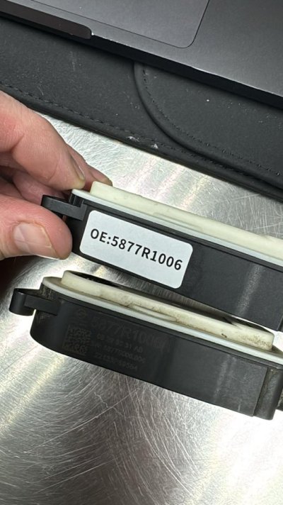

2022 Ram 1500 newer body style with a 5.7 in it, Check engine light is on. I got P1D73 on the reader.
The Grille Is off and i got the motor for the AGS out, its part number is 5877r1006A, i got power on the Red wrire coming in.
So i think its the actual motor, now im looking and dodge doesnt just sell the motor it sells the whole AGS grille with the motor for almost 800 candian.
i just need the motor, so i picked up one with part number 5877r1006 no A at the end of it....plugged it in and no movement on it when i started the truck. But did some digging and found a few other Chrysler cars have had pin issues with the AGS MOTOR. ....anyone know if that may be the case? or what kinda of things i should be looking for when trouble shooting.
