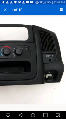

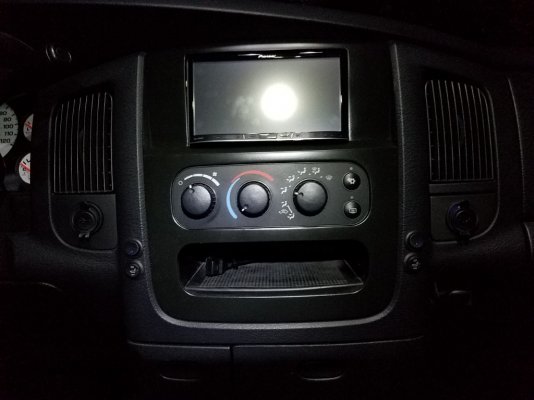

Hello all, I've had this 03 1500 SLT for the longest time, and I have always wondered what that plastic piece under the 2nd vent in the middle of the dash was for.. It wasn't 10 minutes ago i finally looked it up and finally found out what would've be there.. An airbag switch! Im the kind of guy who likes to have all the bells and whistles so I was wondering if that switch is just like something you just plug in and that the connector for it hidden behind the dash? Thanks for reading!20180204_104631.jpg Screenshot_2018-02-22-00-41-07.png

There should be a connector for it, plugged into a dummy plug on the back, right by that plate. The plate just screws into place with 3 screws. I thought about getting and installing the switch but instead, I opted to install a dual USB port into the existing plate. I find that to be much more useful than turning the passenger air bag on or off. I also replaced the cigar lighter with a matching USB port.

Would I have to take the truck into the dealer to get it programed? Or is it a plug and play kinda thing?

Nope. I got those off ebay, they are just a pair of USB ports that replace the cigar lighter. Plug in power and ground and they work. Only for charging, not actually hooked to the stereo or anything.
