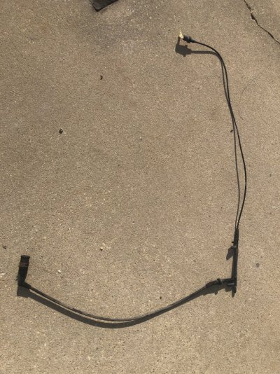

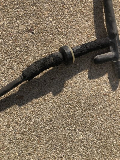

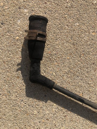

I have a 2002 Dodge Ram 2500 Diesel. Had a similar issue with my AC blowing up through my defrost. Turns out it was a vacuum issue. Parts of the vacuum assembly were deteriorated and causing pressure loss.
Ordered a vacuum harness from my local dealership
Part # 55056421AA for 22.35, took me 10 min. to swap out, fixed my issue.
