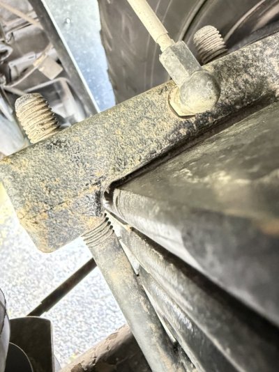

My alignment has been a little borked for maybe a year now. I have to steer a couple degrees to the left. I am getting an alignment done. I just replaced the ball joints and the front tires had their outside tread pretty well shaved off. I've driven down a lot of rough roads/highways close to GVWR. Im trying to figure out why my alignment is bad because something had to shift/bend/break for it to change.
So. I noticed a couple things I don't understand.
First, these two bolts holding the airbags to the frame. The driver side has a gap to the frame and the passenger side is pressed up against the frame. Is that normal tolerance?
Second, the driver side leaf spring bracket has a weld attaching it to the springs and the passenger side does not (it's painted so I assume it was never welded). What's up with that? Is the truck setup so you only adjust rear alignment on the passenger side?

I don't think that's weld on your springs - you wouldn't want to weld spring steel unless absolutely necessary. That looks more like a rubber isolator, which is there to take up any 'gaps' that might exist between the bracket and the spring. Try poking it with a flat-blade screwdriver to see if it flexes.
You don't align the rear axle on ANY solid rear axle truck, USUALLY. Everything SHOULD be fixed, and the perch on the axle tube has a locator that fits into a socket on the spring pack. If everything was machined properly at the factory, the rear axle should be pretty close to dead-nuts with the truck. If you're 'dog tracking' then something happened, either at assembly, delivery, or somewhere. Usually it only happens on a solid-rear-axle vehicle after some kind of damage or an accident.
