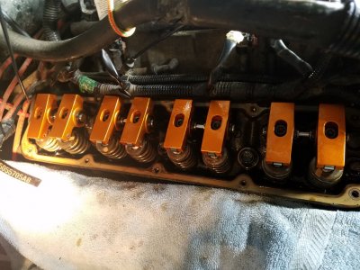

Few picks of the install...cause if you don't post it didn't happen.:head3:

First time installing these....there a a definite tick or clack on the valve train.....Are these rockers always this loud? (I Sure hope the answer is yes....)

Cool thanks, I was hoping they were the new rockers making the tick and not anything else, ya I pulled the valve covers again last night to re-check torque. All good. Truck seems to idle fine. Took it for a quick spin, but didn't get on it. Seemed to be OK.

Any updates? Were they worth the loot? What does your “butt dyno” tell you?

I can definitely feel an increase in the 2500-4000 range. For $400.00 Bucks .....MEH. I don't think this truck will ever "GET IT", but it has a little more ***** in it for sure.
