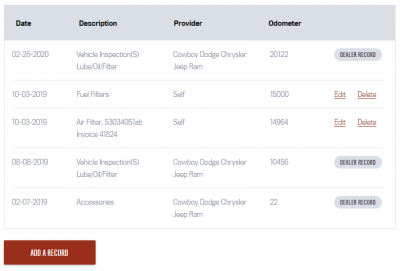

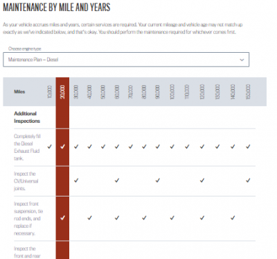

I tow frequently. Change engine oil & filter at 7,500 mi, fuel filters every other oil change, air filter every other fuel filter change, transmission / axles / CV filter every other air filter change.

Thanks. I had signed up, but had not found those. It would be nice to be able to download that first chart into a spreadsheet.
