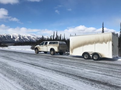

Okay, we’ve explored the numbers and theories, but how did it ride? Well, again I have to admit my lack of experience, but I’d say it rode great. During the trip up we had all kinds of conditions; snow, ice, winds, windy roads, mountain driving, semis, etc. While I could certainly tell I was pulling a trailer I never felt like it was out of my control and that’s what I was looking for.

Well, that was my trip. Thanks to all those that gave me advice and I’m happy to say other than my flat it was pretty uneventful. Safe travels out there!
