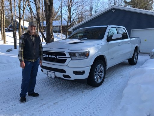

I just put wildpeaks on my truck the other day. Went with stock size but I do have the bilsteins. The tires look great and ride really nice. Had mine on the highway a couple hours after install and rode very smooth at 70-75 mphtruck.jpg . I have pics but they don't do the truck justice. They look so much better in person. I was worried how they would look and was pleasantly surprised when they pulled my truck out of the install bay. May have taken a 2 mpg hit but that has yet to be determined as I also installed a K&N air filter at the same time.

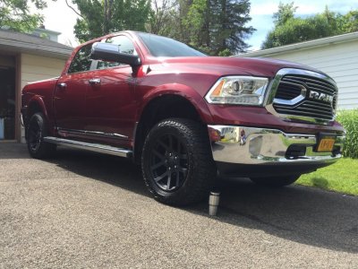

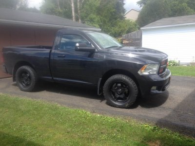

BFG ko2's:
JoeCo
Mar 5, 2014
2,465
2,022
NY
KO2's again:
Falken Wildpeaks:
And falken wildpeaks with a front level:

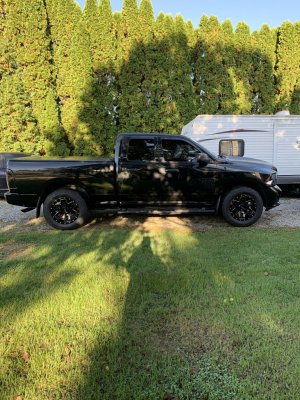

Don’t have any of those particular tires, but I do have a stock 2wd with 285/60/20 Nitto Ridge Grapplers on it. Great tires, ride smooth, very little road noise for a hybrid (AT/mud tire). Only downside is they are expensive and do not come with a tread warranty like most tires

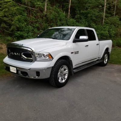

Took my ridge grapplers off for winter, but my sig pic is my truck with them on. Did go slightly bigger 275 65 20. Stock suspension, stock wheels. No rubbing.20190511_201455.jpg

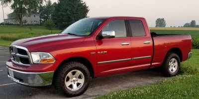

Stock sized duratracs on stock everything else. Bought the truck in january with bald SRAs, duratracs were on the shelf the day I was done playing around. They have seen a few months of the wisco winter expierence and been great so far.
265/70/17
