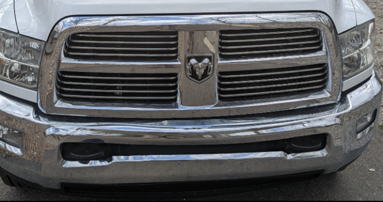

I have a 2012 RAM 2500 Laramie Cummins. The front bumper was a little damaged has a small frowning look the previous owner probably got to close to a post? No frame damage when I purchased it. What bumpers are interchangeable for this year? I want to go-to a You Pull It to get a replacement

Sorry the photo didn't upload the first time.

The difference I've found is in the fog light orientation. The HD trucks have horizontal and the 1500s are vertical.
Also, these bumpers are pretty flimsy. I kissed a deer with mine and was able to pull it back out with a cushioned ratchet strap tied off to my other truck. From your pic all I can tell is it needs to be pulled back out some.
