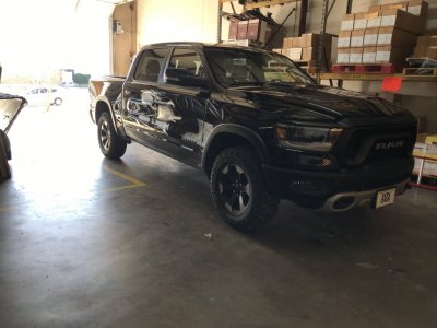

F5899268-78C5-44F0-A9EE-D76C7C4F1B8C.jpeg Hey guys, I recently bought a 2019 Rebel that replaced my 2012 RCSB express.
It has the cargo rails in the bed but no cleats. What accessories are y’all using the rails for? Over the bed storage? Tie downs? Bike racks? Looking for options and I’m having a hard time finding any online.

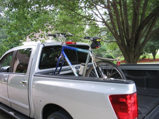

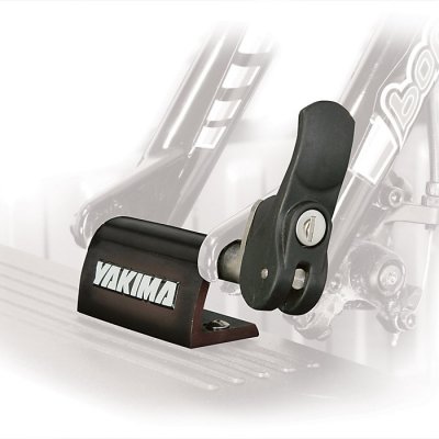

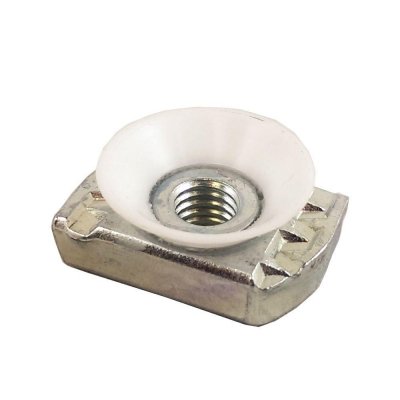

I am not sure about the Ram's rails, but I used to have a Nissan Titan and its rails were sized similar to superstruts rails. This allowed you to use superstrut cone nuts etc. For example, I used those to attach Yakima bike mounts directly to the rail. The possibilities are really endless that way. Home Depot sells the nuts and other superstruts stuff.
