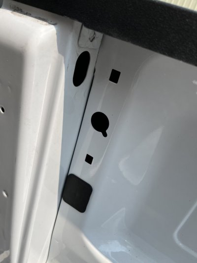

I just removed the hard plastic bed liner that came in the truck & now see there are these holes in the sheet metal.bed side.JPG
I have found one plug to fit the oval holes. Does anyone know if there is a kit to plug the rest?
TIA.
JIM.

ask your Dodge Dealership Parts Dept.
take some pix to show them
My older Ram holes are Oval & Round with rubber Grommets
I suggest that you sand down those rub spots left by the plastic bed liner
spray the spots with rust inhibitor
UNLESS you will be getting the bed sprayed with a bedliner like Line-X

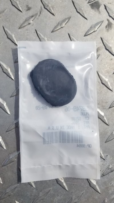

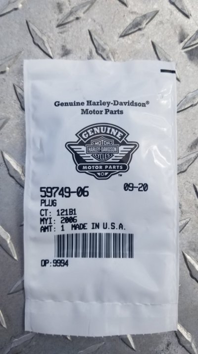

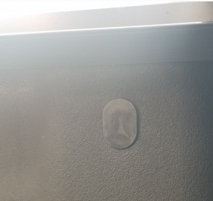

I didn't know Ram made plugs. I used Harley Davidson plugs for the oval ones. Perfect fit and made of rubber.
