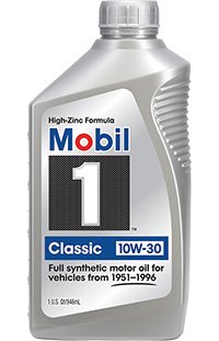

ever since Valvoline VR1 came out I've been using their 10w40 in my old 273. It has a higher zinc content so I no longer deal with the additives on my oil changes for the flat tappet mechanical lifters.
Most of the standard dinosaur oil no longer has the zinc these cams and lifters need.
