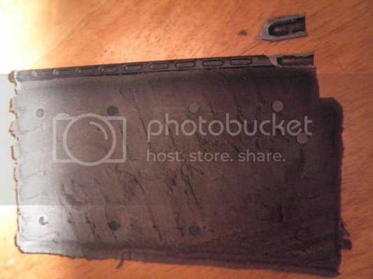

here is what you will be looking at for the replacement
and here is what you will be replacing, i circled the blower motor on the bottom to show you what you will need to remove to get the broken recirc door out.
and here is what you will be pulling out
my man awedaniel found a kit where he just replace the broken door with a aftermarket one made of metal, it cost 130.00 and took him 1.5 hours to change it out. replacing the whole assembly looks to be a few beers long

thanks mike i got i taken care of today. just dropped the blower and reached in there and took it out feels alot better now. And it only took about 10 min. Took longer to get the tools out and put back than actually fixing it.
