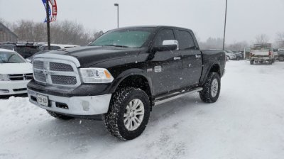

The 5" kit on their site is the level + body lift. I have their 3" body lift on my truck with a 2" front level and a 1.5" rear. I've got 35's on too.
You'll definitely want gap guards unless you like your whole engine getting dirty! You'll also want to get your exhaust raised. I attached a pic of mine.
I'm glad I went with a level and body lift. It's the perfect size for what I wanted and a lot cheaper than a Suspention lift!
