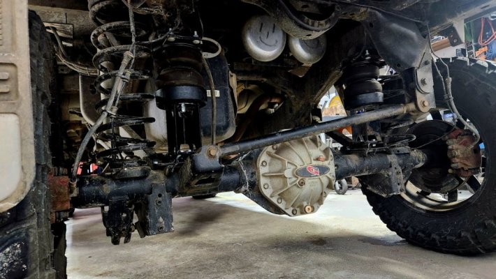

There is zero room to add bump stops. That's why you need to get the bags with them in it.1000016386.jpg

There is zero room to add bump stops. That's why you need to get the bags with them in it.View attachment 584723
The bags I bought to replace the dead bags did have them, but the hardware is so buggered up, and with the new springs I sit to high for bags, well without spacers that I want to get rid of the airlift or whatever hardware is there and put bumpstops back in

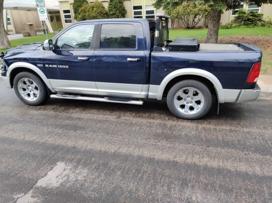

That and frankly with the springs I put in, airbags are redundant :p Like I have a bumper pull camper attached right now, with a full load of water, no weight distro, no sway (just doing a short in town trip with it) and it's sitting just above level. Attached is my '12 1500 with 1700lbs of concrete pavers in the bed and 600lbs of tool box/headache rack/etc, and it's sitting level.. with the same model springs. I was going to replace the broken bags cause it has the Wireless Air and and and til I saw how messed up the hardware was, so now I'm just looking to simplify.
