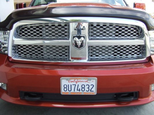

2009 - 2012 Ram bodies are the same
2013 - 2018 Ram bodies are almost the same
In 2013 the Ram 1500s had a slight grille, upper valance & front bumper shape change
the 2009 - 2012 grille corners are rounded off
the 2013 Ram 1500 grille has the lower corners cut off
2009 -2012

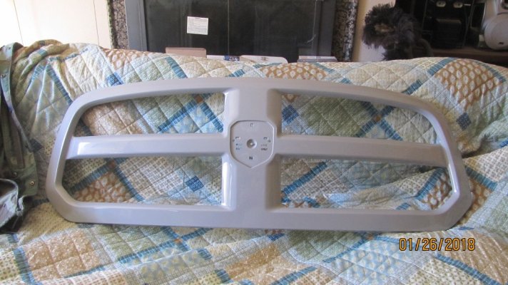

I have a 2010 ram1500 and I also have a 2013 grill and bumper cover can anyone tell me what else I need to put this on my truck Please and thank you
I remember seeing another thread that listed all of the parts necessary to perform this swap but for the life of me I can't find it.
One thing though, I have put the 2013 grille on the 2010 trucks with just some minor modifications to the grille and it fits nicely.
