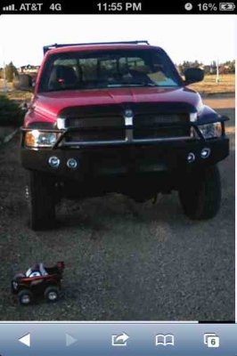

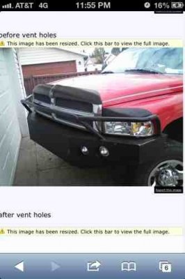

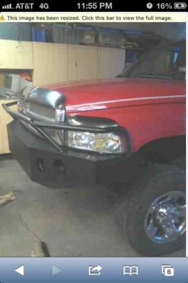

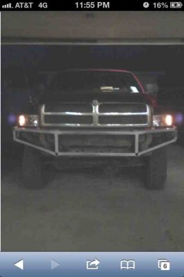

Hey y'all I'm looking to see who has built there own bumper for there 2nd gens . I'm looking to build one cause I have a welder and some material but may just buy all new . So please post up. Bumpers you've made .
If you can't dodge it RAM it !
TexasCornBread
TexasCornBread
Oct 26, 2012
205
Old River,Texas
1999
5.9 magnum

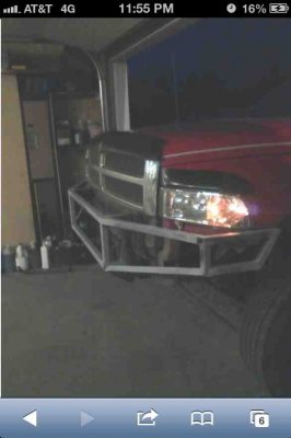

Here's the bumper ill be building . Found it on another forum but exactly what I'm looking for ! ImageUploadedByTapatalk1351920047.007335.jpgImageUploadedByTapatalk1351920058.392366.jpgImageUploadedByTapatalk1351920070.139778.jpgImageUploadedByTapatalk1351920079.873566.jpgImageUploadedByTapatalk1351920095.165273.jpg

Ckeck out road rhino. The come pre cut and pre bent. Wild grind and coat. Ton cheaper then a pre built. I made a thread on my build. Its on a gen3 but they have them for gen2. Ill try and find the thread later.

That's a pretty sick bumper red !

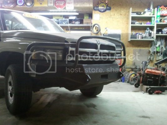

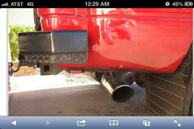

Here's a rear bumper I love and going to make for my truck ImageUploadedByTapatalk1351951094.685890.jpgImageUploadedByTapatalk1351951114.544855.jpgImageUploadedByTapatalk1351951126.201391.jpgImageUploadedByTapatalk1351951139.318860.jpg

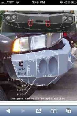

Here the full measurement blueprint of the bumper posted above ImageUploadedByTapatalk1352152224.641026.jpg
