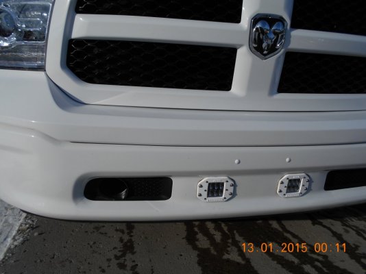

By any chance are you guys talking about these or the longer version?
I was also trying to get mine out so I can mount some Fogs
