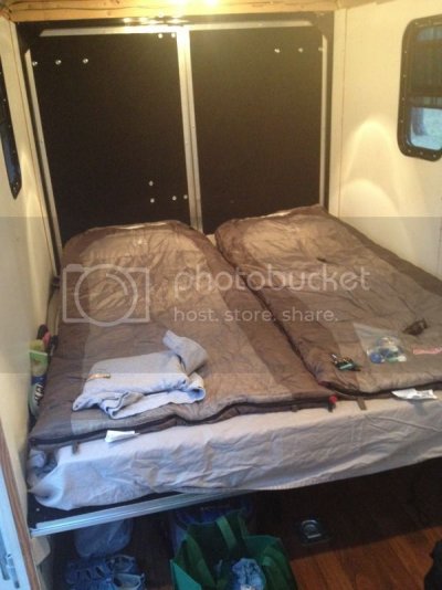

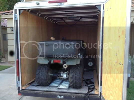

Check out Teardrops n Tiny Travel Trailers • Index page
Lots of people will buy cargo trailers, and convert them in to "redneck travel trailers" by finishing the inside, while still maintaining cargo hauling ability.
I'm one of them. :) My redneck travel trailer is awesome. Hauls two quads, and doubles as a camper. Sounds pretty similar to what you want to do...
"Semi finished:"
Before, but what is still hauls:
Check out the Cargo Trailer Conversions section.

I helped my buddy do that to his car hauler, we put in a sink, hot water heater, outside spicket for a portable shower and he got a kitchen table that would fold flat to the wall, open up to a table and then could be folded into a bed
