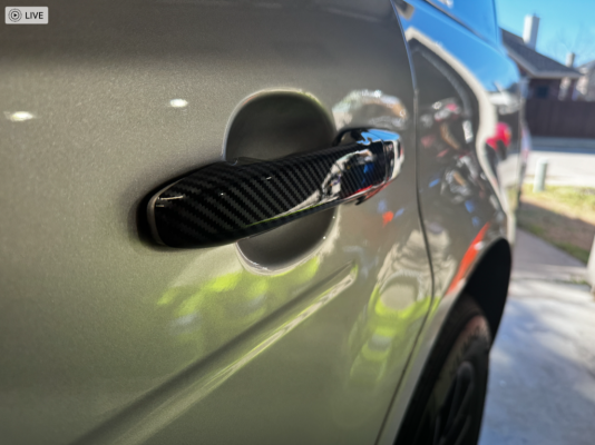

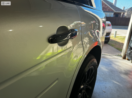

I just did a real quick polish Koch Chemie F6.01 and their yellow pad on my new carbon fiber door handle covers on my Flex. Then I coated it with Koch Chemie Ceramic C0.02 like that's on the Ram. No filter used. I really like that coating. First picture is before and the next two are after.

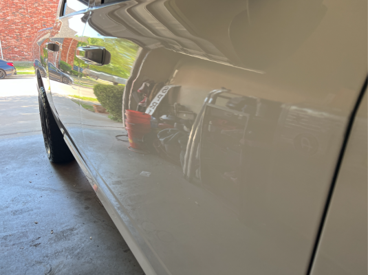

It all comes down to the detailer. You almost always need a two step. Even on new cars. Cut/Polish. A lot of detailers wont take the time when its time to polish to figure out what gives the best clarity. I know my usual go to, but on my Z28 it was something totally different. The only 5 coatings I would ever let touch my vehicle is Cquartz and not the ones you can buy without a license. Modesta license only P&S licenses only Koch Chemie C0.02 or Undrdog Pro or Pro+ no license needed. I like Undrdog because it gives you the look of something like Cquartz without breaking the bank. Ive got Pro+ on two of our cars, and the ram and the z have Koch Chemie C0.02. Not all coatings are created equal and you will hear this and that, but personal experience I wont own anything that doesn't have one of those coatings installed.

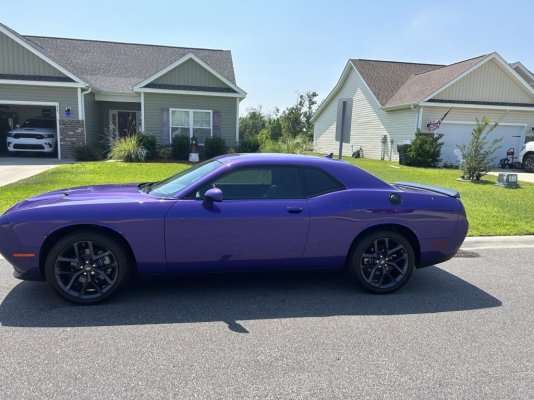

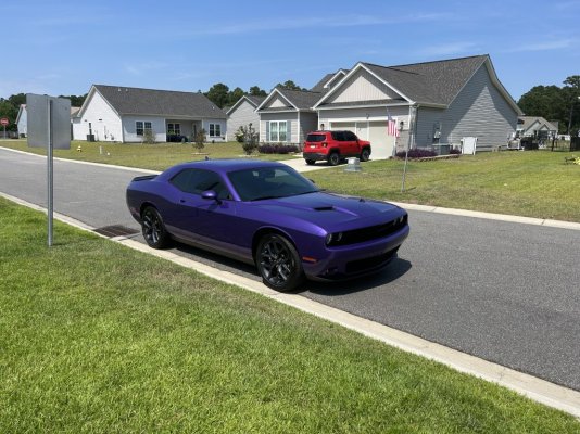

We just had the daughter Challenger done in ICON ROCKLEAR. Happy with the initial results, let’s see how it hold up.
Did the body, wheels, and glass

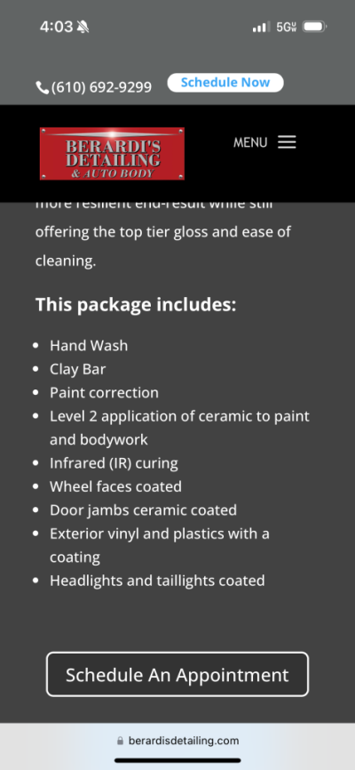

So here’s the latest. I got quoted $2k from a guy in west chester pa. Seemed like he didn’t wanna talk much lol. Here’s what the quote includes. Is this a reasonable price?
