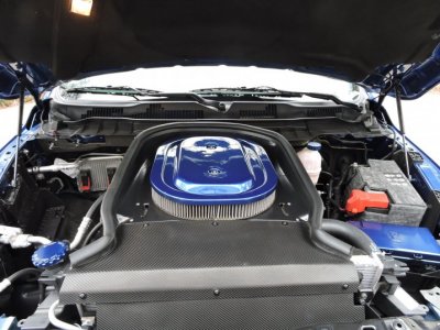

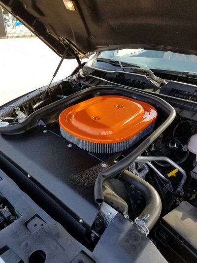

My Vararam--does a good job, looks good, tremendous horsepower gain if you pair it with a "catch can" :roflsquared::roflsquared:
Jay
