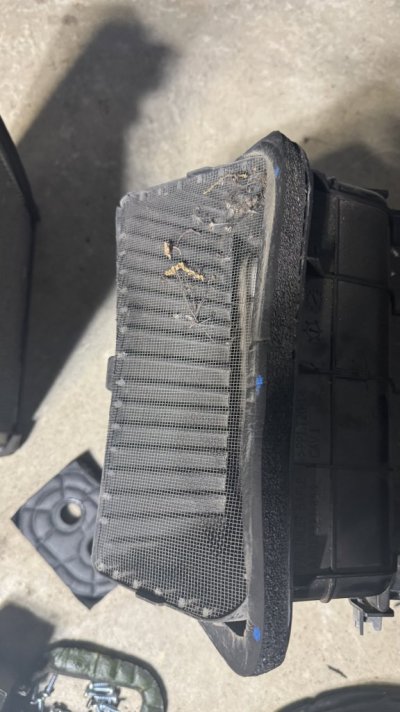

I also have a 2016 2500 with a 6.4, my heater core started leaking so I’m currently replacing both the heater core and the evap core. If you’re not mechanically inclined, I recommend taking it somewhere, it’s a PITA to get the dash out to service this.
I’ll make a ted talk post when I’m 100% done installing about how many design flaws this hvac unit has, but I’ll tailor this to airflow specifically for you. Since there’s no cabin air filter, all the dirt gets in your evap core (and beyond) and clogs it up pretty bad. Get the temp sensor as well, mine was filthy. Also everything is there for you to install a cabin air filter besides the cover. You do have to cut out the plastic they have where it should go, but it’s pretty easy with a plastic cutting wheel and a file.
I attached a picture of my old heater core, old evaporator core, the leak in the housing, the sad excuse for a “filter”, and the hole I cut in the inlet housing for a proper cabin filter. If you have any questions let me know!

WOW that is bad !
And WOW what a job :O
And there are still people who say a CAF is not needed
My 2015 I got in 2016 did not have one but did the CAF mod and from the crap it has caught worth the mod 110%
A CAF is cheaper then a coil and evap
