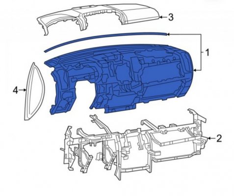

Fc3s25
Jul 26, 2020
23
California
Screenshot_20230218_124507_Chrome.jpgDoes any know the PART NUMBER FOR #3 or even the correct term/keywords to search online? *For 2019 Ram 1500 Laramie Gen 5* @AllMoparParts.com

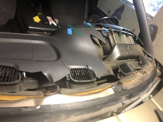

Mike68
Apr 18, 2020
10
US
2001
360
Geno's garage.
They make a strengthened Dash for these trucks.
Mine should get here today.
They've reinforced the attach points, and make it out of a heavier duty plastic or something.
Check it out online at "Geno's Garage"
I will share my results as soon as I get it installed.
I was in the process of having my winshield replaced and removed the rug dash cover while doing so.
My dash had crumbled into about eighteen pieces
Mike68
Apr 18, 2020
10
US
2001
360
I installed my new dash today that I received from Geno's garage.
My truck is a 2001 2500 ram.
I googled pulling out the glove box and passenger airbag.......piece of cake.
The instructions say to drop the steering column down, but I did not do that.
My old dash top was so bad, that there wasn't enough left to glue a cover too.....which is why I went with a complete replacement.
Windshield is coming tomorrow.
